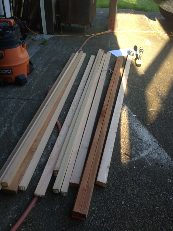

Grabbed some lumber at the Home Depot while I was in town (Aberdeen) and purchased the cage wire from a couple of feed stores in Montesano. I couldn't find the 1/2"x1" 14 GA floor wire for the house portion so I had to settle for 16 GA wire.
I decided to use pressure treated lumber for the all the 2x2's that contacted the ground. The wood wanted to split so I pre-drilled the holes for the 3" deck screws that connected the runners to the floor joists.

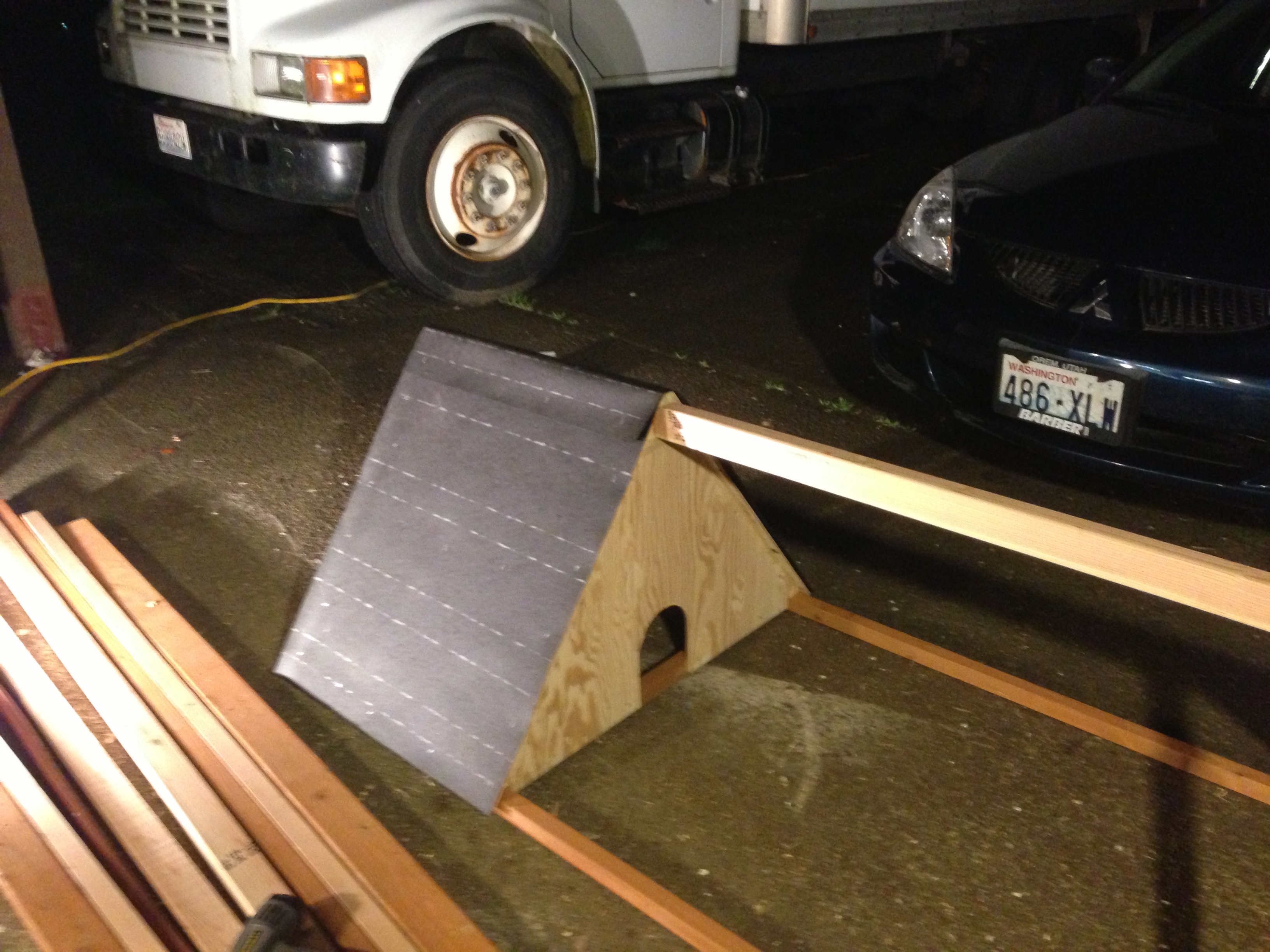

Next I layed out the wall panels, jig sawed them out and attached them with 1-5/8" deck screws. I used deck screws instead of nails for most structural components because the rabbit hutch was designed to be moved around alot and I didn't need nails working loose over time.
I should have attached the floor wire/mesh prior to attaching the rafters to the runners. Instead I ended up building a separate frame with the floor wire attached that inserted into the opening in the floor of the house. This method involved more labor and materials but it also makes the floor removable and replaceable in the future. Plywood for the walls and roof is also a much better choice than OSB, especially in wet climates.
Next I attached the roof panels making sure I had the proper overhang on all edges and also checking for square.
With the roof panels attached all of the major framing was done then it was on to the roof and hardware.

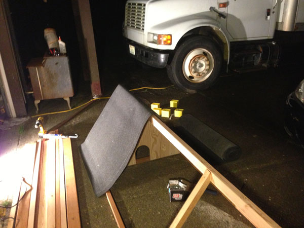

I had some 15# roofing felt leftover from the last construction project. That went on first with some staples and asphalt roofing cement.
Next came the rolled roofing, which I simply rolled over the top and attached with some 1-1/2" roofing tacks and some more of the roofing cement. Cutting the rolled roofing was troublesome, it seemed to want to tear more than cut using a standard hooked blade. Eventually I gave up on trying to cut it with a razor and used a large pair of shears, which by the end were completely ruined.
Along all the edges I ran a bead of the roofing cement to keep out the moisture and also to keep the edges from peeling up in the windstorms we get during the winter. This little roof isn't going anywhere. I also covered all of the tacks over with roofing cement to seal everything up nicely.
